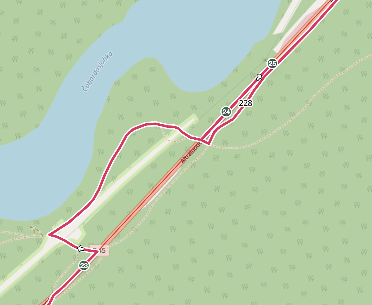

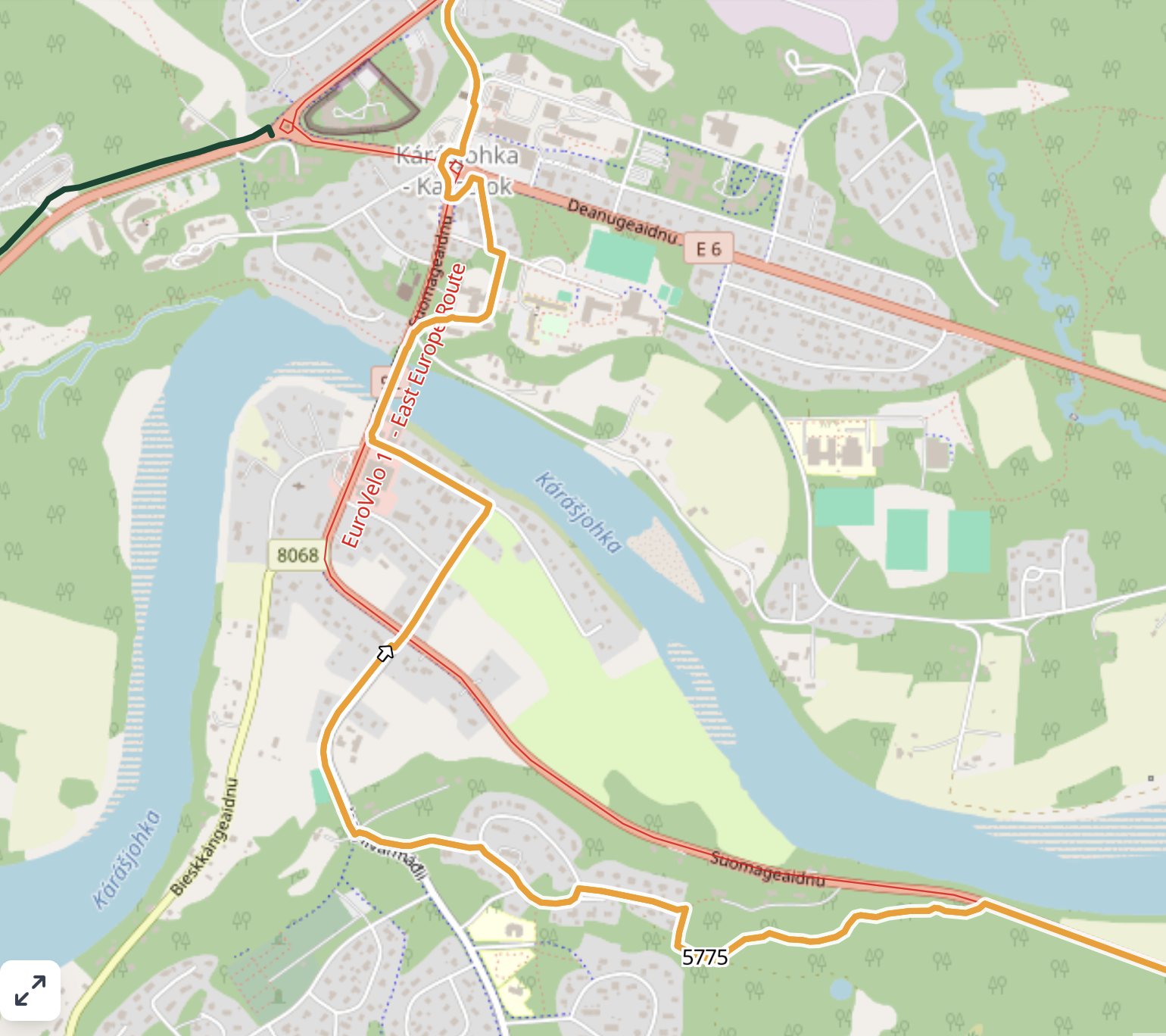

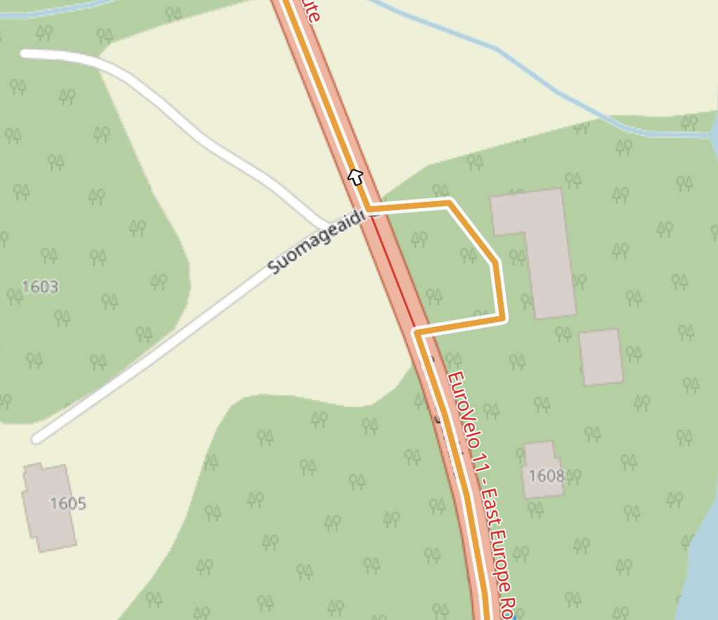

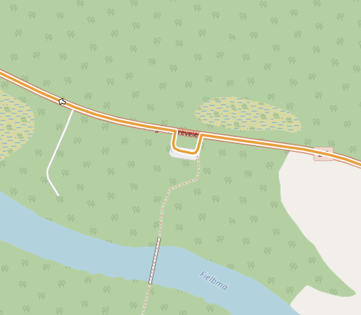

When planning a route that goes along a main road, the routing is trying very hard to avoid this main road at any cost. This is often a good thing, but it causes very short deviations from a main road, even if Eurovelo or other routes go along the main road. Even after setting multiple waypoints (see screenshots2), the routing still sticks to the side paths and goes back and forth between the waypoints. Took me up to 20 waypoints to stick to 1km Eurovelo on the main road and not take any weird deviations. Possible fix: Adjust routing behavior for going on and off the same road (maybe with a minimum distance). Additionally, turn off any short and unnecessary deviation IF there is an Eurovelo or route on the main road, especially when having the touring profile selected. Maybe the exact routing behavior for those deviations could be programmed into the routing profiles or an additional setting?

Kacper Golinski Yes, happens in several profiles. Sometimes even in "road bike". After some testing, it seems to be a Norway-specific issue. Since it doesn't seem to be possible to search with coordinates, I created you a route with different stages all highlighting the same problem: Avoiding the main road at all costs. The first stage isn't really about Eurovelo, but the 430km detour for a 50km route is still pretty interesting. https://veloplanner.com/user-routes/1575

Kacper Golinski No I think it's fine since rerouting with waypoint works okay now. Deprioritizing probably would hurt though. Maybe a routing preference to "avoid ferries when possible"? Would work with any kind of road category or surface. Random idea: Hide those settings under a new "Custom" bike profile so you can specify your own routing? What really needs fixing in my opinion are those tiny deviation when you are on a main road: Go off and then back on the same road just a few meters later. I cannot think of a single case where I would prefer this kind of routing instead of just going straight. They are extremely annoying for turn by turn navigation and take quite some time to fix since one waypoint usually isn't enough.
